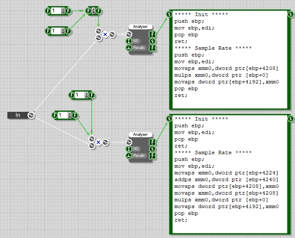

Question... anyone know how this prim works inside or looks in Ruby?
Edit: Seems slightly different from just doing a for/while/times loop in the Ruby box. Might be a changed and/or samplehold behaviour due to having stored internal input variable, but still passing the trigger along...
Noticed this "carry over" to poly... after working alot in green. I have to go through alot of my poly schematics or?
Edit: Phew!... luckily wasn't that many
