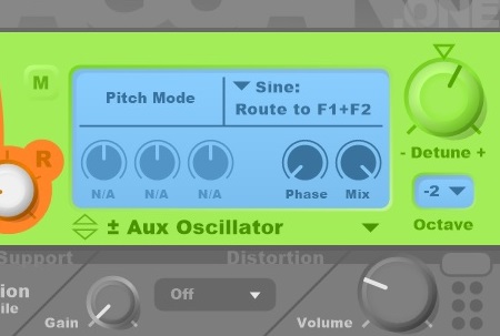

I'm going to look at these modules closer and test the performace later. You and Tepeix took a different approach which is nice...
I highly suspect Tepeix version works well inside my LFO, because there I only need the Split Exp functionality... and MV's version for the Aux Oscillator.

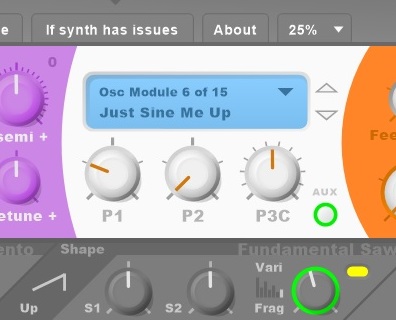

This will be a DAMN NICE update (subjective for me atleast as newbie
Knobs already in place from previous version...
Slice and Frag modulatable, now with Vari modes. Either retains/adds some sizzle at high reso or makes a trash:ier sound... Fit perfects for the plugin since it's a techno synth.
Also thinking of making a Random mod section for Note pitch, Amp, S1, S2 and Slice/Frag. Based of Adams random ASM snippet that I think Spogg shared here somewhere.

Have played around a little bit now with these modules of yours...
Tepeix version will definately go into the LFO since it can flatten out exactly like my original... and that shape
makes for quite a good LFO wave
Haa!
Moreover, the math in MV's version had a bonus up it's sleeve... that made it a "two for one".
Seems i'll get yet another oscillator style from the same modules. Interesting!
