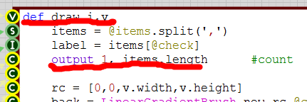

Re: RUBY: Droplist selector uses massive CPU when copied
This is what I'm referring to.
But the two lines above it also doesn't belong into a drawing method, since they create anarray from a string and evaluate one of the created values. That's all time consuming, when several redraws take place. The method is called "draw" for a reason
Thank you SO much tulamide!
I do believe I actually understand this now
I’ve re-worked the RubyEdit and all seems well now, but maybe you or someone else could have a look to see if there’s anything else stupid remaining.
This has been a great learning experience for me so, again, thanks to all for joining in.
Nicely done
I couldn't spot any more issues from the code. There is still a good part of optimization possible, but nothing drastically. For example, you could define all the pens and brushes as class instance variables in the init method. This will save a little bit cpu load, but more importantly doesn't claim and release so much memory. Instead of doing it per draw call, it is only done once at the beginning. This will reduce the load to the gc (garbage collector), that has to take care of releasing classes and variables that aren't used anymore, which is a time consuming process.
