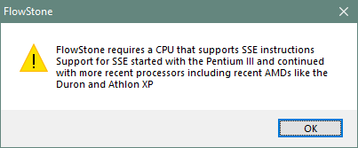

I just installed Flowstone and get the error when i try to use a DS(direct sound) control.
DS_GENERIC_ERROR
I have as sole sound interface a Steinberg UR12.
Windows 10
What could be the problem?
DS_GENERIC_ERROR
Windows 10

Re: Having problems with Direct Sound error.
Hello and welcome!
This isn’t the first time I’ve heard of Windows 10 DirectSound issues with FlowStone.
It may be driver related or have other causes but the answer is to always use ASIO. ASIO is so much faster and responsive in any case.
If you don’t have an ASIO driver you can use the free and excellent ASIO4ALL
http://www.asio4all.org/
Installed setupFlowStone_3_0_8_1
Now getting error dialog
CPU is intel i7-7700 3.60GHz
Then error "Schematic load type not found"
and
"attempted to access past its end"
This is very annoying.
and

So installed BETA2 again and it just randomly crashes no error message.
