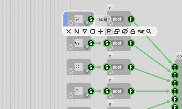

@tulamide
If you open the version in this link, all the “eye” symbols for the labels are crossed out:
viewtopic.php?f=2&t=14539#p47584
I do recall seeing this ACM when I was just starting out with FlowStone, and I had no idea what it was about or how it could be used. I think that your vision for its application, in a real project or demo example, might have attracted more attention at the time.
What I really like is that you can choose a base colour like for example, now let me think… orange, then create various shades from it with the same basic hue(if that’s the correct term). Very neat!

Re: I need help // generic color mixer preset manager
Then I think that what I'm calling the label modules must be misleading, sorry.
Here's what I'm seeing:
Maybe I'm just getting too old
Now I understand what you mean, and yes, they were meant to be seen (I haven't touched them and they are active on the original I uploaded on GURU, so I don't know what caused it), so thank you for the good deed
tulamide wrote:Maybe I'm just getting too old![]()
Jeez, if you are getting too old, what does that make me? A relic maybe
The really puzzling thing is that I had to make them all viewable individually. Does this mean you took the same action 8 times, then forgot?
