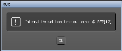

I'm crashing MUX running as VSTi in Orion too.
Here is the error->
I'll think about what to test.
Here is the error->

Here is what Mutools said about the error->
Unfortunately i can't help in analysing/debugging Ruby code. I have too much work myself too. But maybe as a helpful hint i can tell you that that MUX alert ("Internal thread loop time out") most probably comes because the audio processing thread is blocked in some way, which may also be the reason why Orion crashes when you use the Ruby plug directly in Orion.
end
