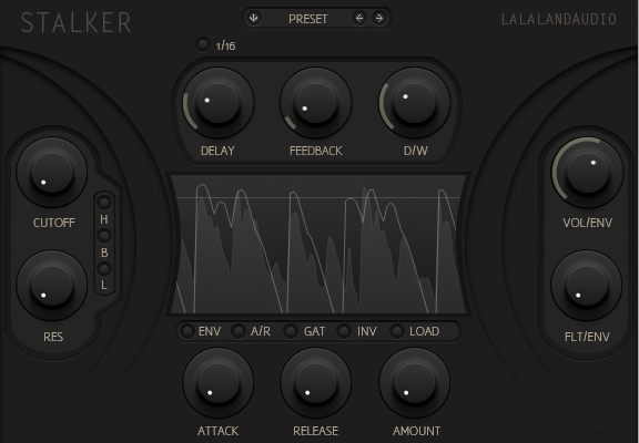

Postby tulamide » Sun May 19, 2019 7:15 pm
Beautiful screenshot! I love Stalker! (A filtered delay effect?)
Re: Knobs made in blender.
Postby lalalandsynth » Sun May 19, 2019 8:44 pm
Its actually an envelope follower with sidechain to control either volume or filter.
Send drums into sidechain , bass into signal and either filter it or control the volume with the drums.
You can set the sensitivity with dragging the threshold line , you can also invert the envelope.
You can use the envelope follower for this or an AR generator derived from the input signal.
The delay is what makes it special as you can delay the sidechain signal for syncopated rhythms , set the dry&wet and even add feedback.
You can also load a wavefile as a modulator , auto synced to tempo.
