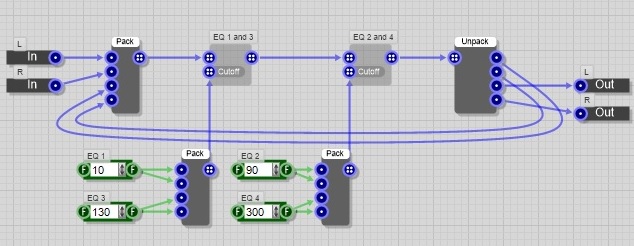

you cold save tons of cpu if you pack the dezippers together and you could save even more if you use the additional 2 sse which you are not using for the other EQs. You could almost cut the cpu usage in half.

Hmm, pack together? sse.. Hmm. I've done things like that but never put that to words. Could You possibly ellaborate?adamszabo wrote:you cold save tons of cpu if you pack the dezippers together and you could save even more if you use the additional 2 sse which you are not using for the other EQs. You could almost cut the cpu usage in half.

This is how you do it. the SSE channel 1 and 2 is for left and right and channel 3 and 4 you can use for another left and right. So in the picture you can create filter eqs in series with just 2 instance. you get 50% cpu reduction. Then you can also pack your values and send them to the correct eq

Thanks Adamadamszabo wrote:This is how you do it. the SSE channel 1 and 2 is for left and right and channel 3 and 4 you can use for another left and right. So in the picture you can create filter eqs in series with just 2 instance. you get 50% cpu reduction. Then you can also pack your values and send them to the correct eq
