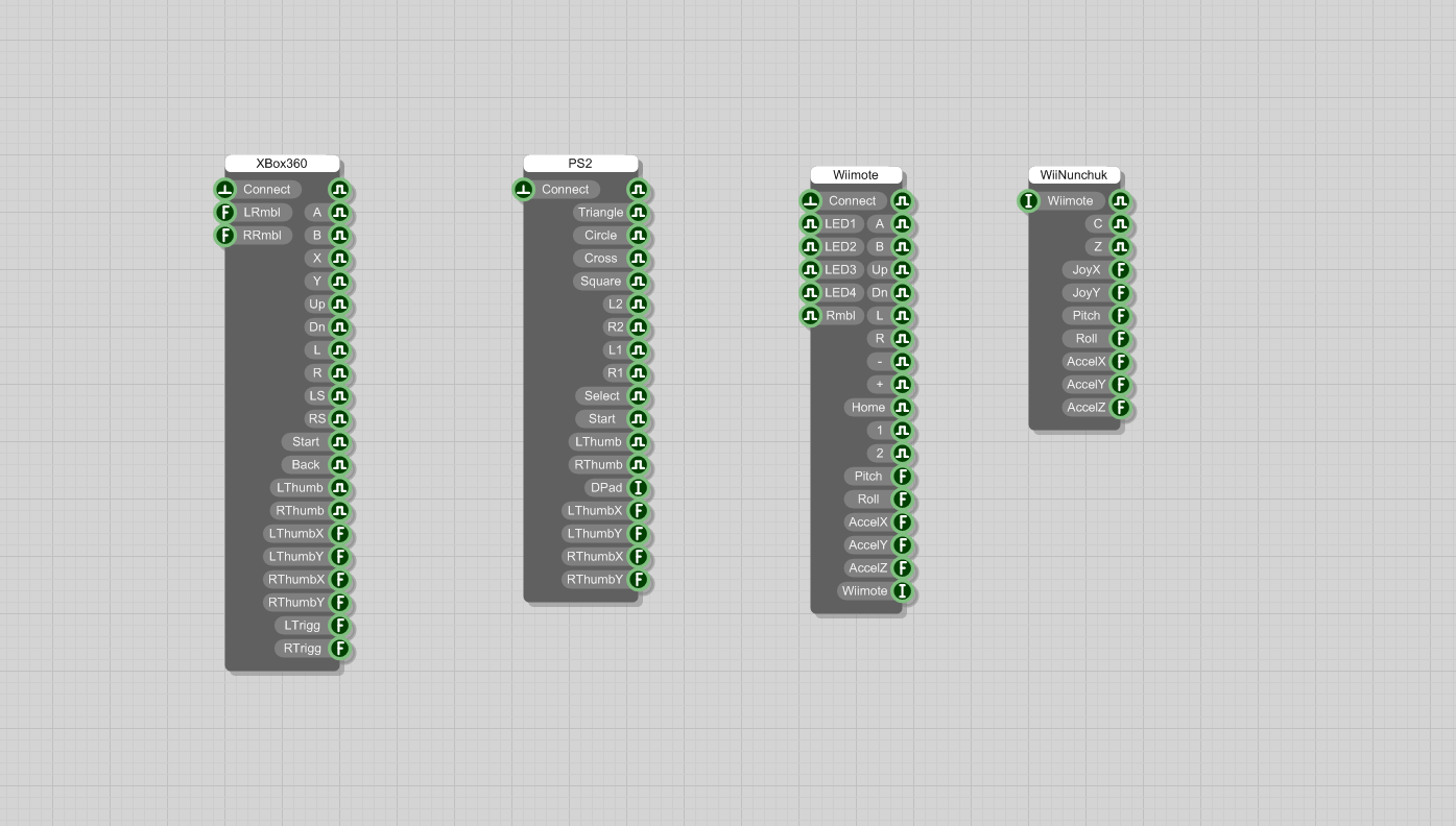

I would just use an Xbox controller or a PS2 controller (from LynxMotion) as these are already fully supported. Another option would be to use the Wii Mote:

If your controller is optical and not potentiometers, you can still interface with it in FlowStone. Optical motion detection systems use two LEDs with two photodetectors to form a quadrature encoder. This is exactly how an older, “ball” type PC mouse worked.
As you move the shutter-wheel (either a joystick, older mouse, DC motor with feedback, etc.) the photodetectors generate a series of TTL-pulses with a lead/lag signal phase which tells the interface speed, direction, position, etc.
The Phidgets 1047 PhidgetEncoder HighSpeed 4-Input device will read those type encoders and FlowStone will let you process the data based on your inputs.
Or, as mentioned before, with Wii Nunchuck gives you lots of motion detection with lots of capabilities from an inexpensive game controller.
