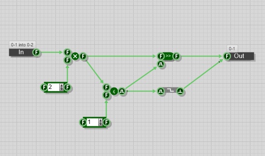

Here's a question for the real coders:
This will stop sending trigger halfway of a knob.
I block triggers this way when I use like... log10 and some "power" operations afterwards, that aren't needed for half knob turn... this seems justified.
But how much green does one really need afterwards to justify this, and the constant overhead of running it?
Log, power, or a whole bunch of divisions maybe?

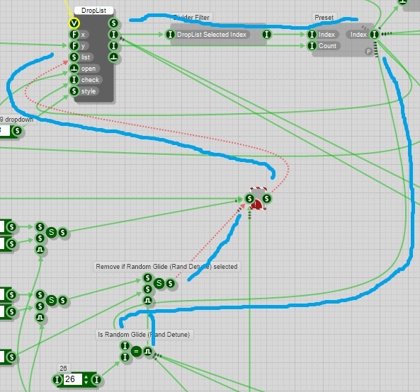

The Alpha thinks this is a problem, but old FS does not...
So the logic would be that update to the list cases a trigger in the Dropdown prim outputs. But this isn't an issue with old FS?

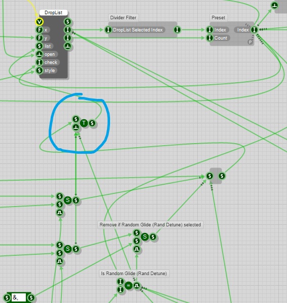

R&R wrote:The Alpha thinks this is a problem, but old FS does not...
Easily fixed with a S&H... But clearly a difference between FS4 and old FS.

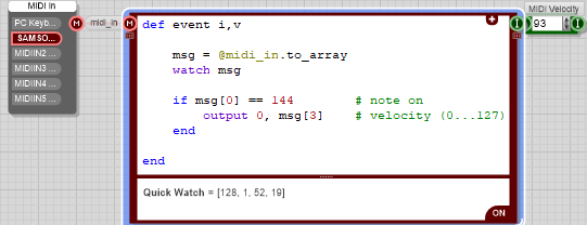

Here is an alternative (FS User Guide p.219f):
(Note: To avoid confusion: The MIDI message displayed in the lower Ruby panel (Quick Watch) is not a "note on" but a "note off" message, hence the different velocities.
Note On: 93 (green output)
Note Off: 19 (lower Ruby panel)
I could not manage to sustain the note while taking the screenshot.

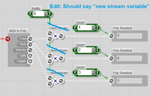

Not a green question. Breaking my own topic
I'm so slow
Could just sacrifice resources by using more Poly's and filter out by Id, or perhaps by any other arbitrary value I guess...?
Anyone used an "early in schematic bus creation" type of scheme in elaborate more global way in any of your FS plugins?
