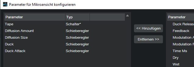

This has nothing to do with Flowstone. As Spogg already explained, ALL parameters are always a 32-bit float number. This is a problem of not fully understanding your DAW. Unfortunately, you didn't mention it, but from the screenshot and your user name, I guess it's Studio One, in which case, I can help you.
You're confusing the micro view with automation. The screenshot shows the micro view of some of the insert effects. You can configure any of these by right-clicking on any parameter in the micro view and from the context pop-up choosing "configure micro view parameter" (I only have the German version, wording might vary).
A window opens that shows used parameters on the left and the pool of possible parameters to add on the right. In the left part you will see 2 columns, "parameter" and "type". Hover over the parameter's type you wish to change and right-click. This allows you to change the type to "switch". Then close the window. I made a screenshot of me turning the "tape" parameter of a plugin into a switch.
But careful: This change will also be used in the automation track. It sets the automation value to hard 0 and 1.

Thanks guys, I should have known that I could manually switch it.
It was more that other plugins showed their switches automatically as switches and I didn't realize I could edit that.
Thanks a lot, much appreciated.
