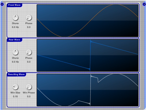

Re: WTF Oscillator
Here is an alias suppressed WTF module (I like the name
). Take your two favorite waveforms and off you go. Try detuning the frequencies (slightly).
I am thinking of releasing a BLEP kit which would be sort of general purpose and would facilitate, among other things, alias-suppressed syncing.
For now happy WTF-*ing!
WTF.fsm- Updated
- (49.33 KiB) Downloaded 939 times
- WTF GUI.png (53.13 KiB) Viewed 19010 times

Re: WTF Oscillator
Hi Martin,
I love the sound it generates, esp. when modulating. But I don't quite get the purposes of the phases and such. In the WTF Eurorack module it is so easy to use: Front, rear, window. What is the equivalent of window here? I guess the knob at the bottom. But what is the knob (phase) right above then in this analogy?
Thanks!
Thanks!
