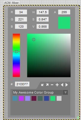

Spogg wrote:I imagine there could be a few of these at a high level sending out a few colours via wireless, so you could change the colour scheme easily.
Actually, this is only revision 4 of that tool. Since I uploaded it on GURU, I developed it much further (but without preset support). The latest version uses Ruby trickery to have its own kind of "wireless" connection. The two-component system is now called Advanced Color Management (or Advanced Colour Management for Spogg), short ACM, and is the central management tool for every color of your whole project. Little receiver modules are linked to whatever color input you have, and when creating a plugin, those stay in (they preserve the last color under all circumstances), while the manager is not part of the plugin.
The manager however doesn't have a simple palette anymore. Instead you create "groups". Each group can store as many colors as you like. And you can create as many groups as you like. The groups get a name, too. I even support importing Adobe Photoshop color palettes.
For example you could have a group "Big Knob", which contains all the colors you need for that knob, and a group "left slider", containing all colors for that slider. Then, when using one of the receivers, and that's the clue of the "wireless" connection", you open the porperties panel and from there select one of the named groups and a color from that group!
It's a lot of text, but believe me, it's dead simple to use.
Unfortunately, Flowstone 4 has so many changes (Ruby 2.5 instead of 1.9.3, an overhauled toolbox, etc.), that it broke one or two features. For example, trying to put both elements in the toolbox instantly crashes to desktop. It worked in Flowstone 3.x, though.
Here are some images.
