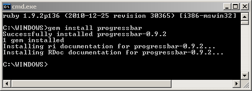

Step 3) download Install Gem on your system:
Put the downloaded gem in the gem folder: D:\Ruby192MSwin\lib\ruby\gems\1.9.1\gems (using your own path)
then in Ruby:
gem install gemname
You should see the gem install:

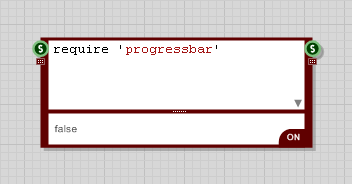

Step 4) Add the new path to FlowStone's ruby
Open FS2 and enter something like this into a Ruby edit module:
$LOAD_PATH << "D:/Ruby192MSwin/lib/ruby/gems/1.9.1/gems/myGemFolder"
Remembering to use / not \
This only has to be done once!
Step 4) Test Gem
Start with a new Ruby Edit module and test if it loads:
ie. require 'MyGemName'
Results: the first time it load you get a result of True, from then on False - both are good it has been loaded!
If the loaded gem causes a crash then it is the gem that doesn't work on Windows NOT FlowStone!
then in Ruby:
gem install gemname
Step 4) Test Gem
