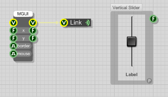

The first thing is to add a wireless link to the V output of the MGUI - Then your LED's & Knobs will appear & yes this does work in FSV2 Pro too!

bryan20miles wrote:When I add a Wireless Output connected to the MGUI, the Slider, Knob and LED do NOT show up on the Module.
This is working fine here:

Step 12: Now we'll try and sprinkle some of FlowStone's magic into the schematic by dragging a Wireless Output Link component from the Toolbox into the schematic view:
Notice how the signal-strength symbol on the Wireless Output Link component's right hand side is dim and that our module's front panel in the Navigator's top view is still knob-less.
Step 13: For some people a lucky number.
Connect the View connector of the MGUI to the Wireless Output Link component and notice how it's signal-strength symbol has turned green to show it has established a Wireless connection with a Wireless Input Link we have yet to meet:
If you take a look at the Navigator's top view, you'll notice our knob is back.
Step 14: To ascertain this, go up a Level and note that it has indeed reappeared:

Step 7: Here we will add a MGUI component to our module and observe it's effect on the front panel.
So step back down into the module again, by double-clicking on it:
Step 8: Drag a MGUI component from the Toolbox into your module's schematic.
It should look like this:
If you look closely in the Navigator's top level view, you'll notice our module has shrunk and seems to have chucked the knob away.
Step 9: Go back up a level so as to ascertain what has transpired in the schematic view:
Step 10: Drag the Resize control to reveal more of the module's front panel and similarly to what Houdini could have done himself, we have managed to make the knob vanish:
Step 11: Step back down into the module by double-clicking on it in order to see if we can get the little bugger back:
Step 15: Go back down inside the module again by double clicking on it, we will now try and understand why the Bitmap module reappeared:
Step 16: Go inside the Bitmap module by double clicking on it and look around to see if there's any connection between the Wireless Output Link and the reappearance of the knob on the module's front panel:
Notice how in the top left hand corner in the Schematic view, a Wireless Input Link component with it's signal-strength symbol is lit and connected to it's own MGUI component.
Step 17: We must be on to something!
Let's now disconnect the link between the Wireless Input Link and the MGUI component to see what happens:
Take a look at the Navigator's top view, our infamous knob has vanished again!
Step 18: Go back up a level to ascertain this:
Step 19: Step back into the Bitmap Knob component and re-establish the connection we had undone:
Now if you look at the Navigator's top view, that son of gun knob is a back again.
Step 20 and final step: Go back up to the top level of the Module's schematic and note how the knob is indeed there, back where it belongs:
