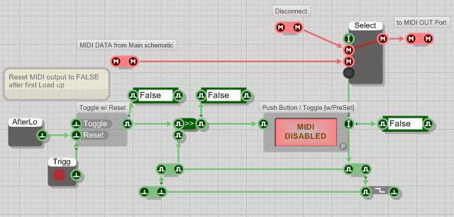

OK ... here is my first idea to dynamically switch/disconnect MIDI output at start-up.
1. The AfterLoad sends trigger to a RESET module that outputs FALSE.
2. into a TRIGGER SWITCH set to pass only on TRUE [supplied by Button Status]
3.If Button status is FALSE, no change [blocked]
If Button status is TRUE, trigger is received/allowed to switch Button FALSE.
4. Button also toggles SELECT routing to main MIDI OUT port.
Tricky ... I had to add a 'Boolean to False' trigger to make the button status switch. Not sure why, but it don't work without it. :roll:
Finally ... the BUTTON must be able to work as expected.
At this point [early in testing], I need to verify that AFTERLOAD will kick in BEFORE any MIDI data leaks out when first loading up the VST.
I also looked at EdOPEN primitive. This could be handy, for as soon as the plugin is viewed, the MIDI connection could be automatically engaged ... ready to go.
With this current design, in order to make MIDI changes, the BUTTON needs to be clicked.
Possible issue ... What if my VST plugin was the last to be viewed [opened] when saving the DAW project. When the project RELOADS, my VST will be the first to open, triggering EdOPEN and connecting MIDI ... that could put me back into the initial problem :|
I know ... this is kinda a strange one to deal with. Appreciate any consoling, ideas ...
Here's the above schematic:
MIDI disconnect at startup-1.fsm
(4.43 KiB) Downloaded 923 times
Thanks Guys for following.

Postby RJHollins » Thu Aug 25, 2016 9:19 pm
OK ... my kill MIDI out is working, and does prevent Reaper from locking up ... that's good.
I would like to make more user friendly, rather than manually having to click the MIDI ACTIVATE button. So I'm looking at the primitive, EdOPEN.
Another candidate ... the 'CLOSE' PRIMitive'. Does anyone know if this works as a function inside a VST format ?
Basically I'm looking to see what options available to proceed.
thx

Postby RJHollins » Fri Aug 26, 2016 7:02 am
Well ... I hooked in an 'OPenEditor' primitive that outputs a BOOLEAN value.
If the VST is OPEN, the primitive outputs TRUE.
The problem. :roll:
It seems the FIRST time the plugin is opened to view, the OPenED is not triggering. If I close the plugin, then THEN open it again ... it triggers TRUE. So ... the plug has to be opened twice in order for the BOOLEAN value to go TRUE.
Maybe this has something to do with having to BRIDGE 32-bit in a 64-bit DAW [using REAPER's Bridge]. I don't know ...
Anyone with any insight or suggestion ?? Has/can this be verified ?
Could really use some help on this .... Thanks !
[of course ... could be operator error ...] :|
RJHollins
Posts: 1571
Re: MIDI data conundrum - FS, 3rd party plugs, & DAW
Postby RJHollins » Fri Aug 26, 2016 7:58 am
---- edit ---
I did another troubleshoot check ... and did find an issue with the 'button' I was using. It was one of the custom buttons from the forum.
Looking inside, the STATE TOGGLE of the button was using plain TRIGGERS to switch the colors and text of the button.
I corrected that by making the select react to BOOLEAN values [on/off, true/false]. This change corrected the visual aspect ... HOWEVER ... the MIS-function was and is, still there.
The VST plugin GUI has to be opened TWICE before the EDOPen boolean triggers the TRUE state. Once you do that ... then it finctions correctly from there out. If I click to button to BYPASS, close and then open the GUI, the boolean goes TRUE, switches the button state, and everything works. Multiple testing proves this out.
It is just that the very first time, it takes 2 opens to start working ! Do you Guys need to see a schematic example ??
What's the problem ... is it because of 'bridging" ?

Postby RJHollins » Sat Aug 27, 2016 4:45 am
Alright ... alright .... so it WAS operator error :oops:
Sometimes [all too often], I make things more difficult than they should be :|
Now I have a working module that does exactly what I need to happen [and I learned a better troubleshooting technique along the way].
What we have:
1. When the VST plugin loads up, the AFTERLOAD triggers a FALSE boolean to switch the MIDI output OFF [disconnect].
This has turned out to be important to prevent double loading of parameters that happen in the DAW. Since each of the 8 to 16 samplers that I'm controlling via MIDI are all getting set by the saved DAW values, AND my plugin also has the same parameters that load and send to the samplers ... it was causing a lock-up of REAPER at the very end when loading the UNDO file. I don't know exactly why it would lock-up [freeze] but it did.
Having the MIDI output OFF during the load up stopped all the freeze problems. I could manually turn the MIDI connection back ON, and everything was working fine.
What I then wanted ... to have the MIDI turned ON after opening the VST GUI [the only time MIDI data would be changed/sent is via the open GUI [and adjustments by the User].
To that.
The AFTERLOAD trigger kills the MIDI.
Connected to the schematic is an EdOPEN primitive tied to a Trigger Delay. When the GUI is opened, this STATE is sent into a LAST primitive. A TRUE will connect the MIDI output.
I also have a trigger going back to the AFTERLOAD section from the EdOPEN, so that when the GUI is closed, the MIDI output disconnects. [I may be able to streamline that signal flow if this is redundant].
Tied to this circuit is a User button that allows manual control of the MIDI output connection. This is important should I make any major changes to my VST core [which would change the order of the saved PRESET Manager ... which usually creates a mess]. With the manual 'disconnect' I can load an updated VST, bypass the MIDI out, and manually match the settings to the collection of samplers under control. Then swap the old with the new, and back in business.
