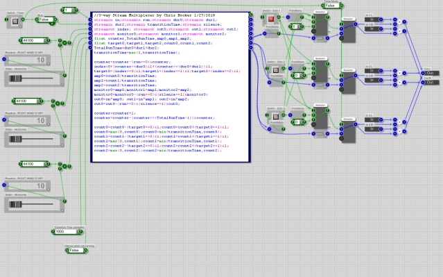

Okay, I just HAD to figure out a "dezipper" / transitioning code, so I finally got it.
Here's an updated schematic with both transitioning and a muting option when the "timer" is turned off.
Be sure to turn on the ASIO Out (or a Direct Out) to get the stream running.
If anyone knows how this can be refined further, optimized, done better in any way... I'm open to learning. Feel free to comment.
Nicolas, I hope this still fits what you need it for.

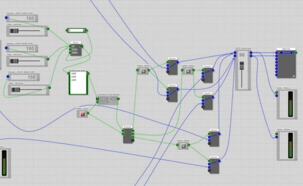

My last posts are not here but I can add information.
Thank you again for your research, it's very interesting
You can see on this schematic the times array and my problem with Str2Arr component when the time is < 100s.

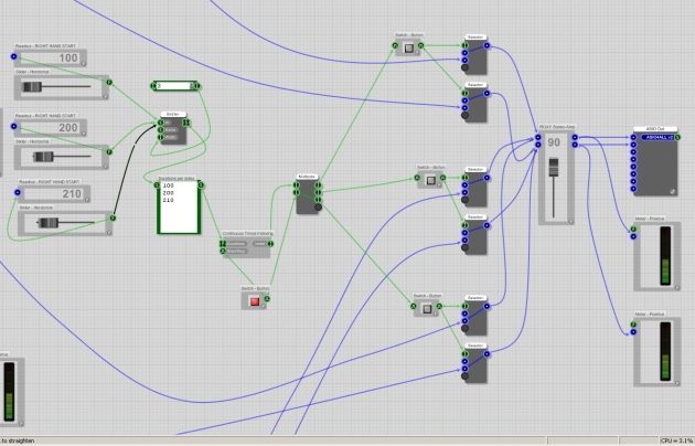

Better picture. You can see input and output link.

Hello Nicolas,
The crashing was likely due to there being an ASIO Out in the original schematic's module. You can't have two in one schematic. In my last post I put it outside the main module, so you should not have an issue with that one.
Now that I can see your intent from your screenshots (the multiplexer is to supply an index for a selector, I've attached a new schematic that acts as a selector for your purposes. This way, you can use it as a soft morph from one stream to the next, instead of a hard switch. Hopefully this should work for you.
continuous_timed_indexing - transitioned stream selector.fsm- (69.39 KiB) Downloaded 908 times
