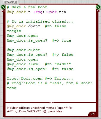

Hmm,
did i miss something?
when i open ur
NoMethodError: undefined method 'open?' for
#<Trog::Door:0xa9a74f0 @open=false
when i open ur
i always get the error:Simple Class Door.fsm

Yes, that's right - I was demonstrating why Tronic's 'class method' style call would not work for an instance method - as in the comments...
# Trog::Door is a class, not a Door!
Re: Ruby namespace best practice.
I understood... but even now?
- Class door.jpg (28.39 KiB) Viewed 16133 times
Aaah - now I see!
Didn't read my own API docs! - the correct method is, of course "is_open?" not plain old "open?" - D'oh!
