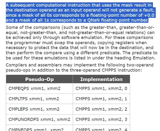

Yep it's sometime head breaker in asm.. Or mind game..
I had to keep a list of all the cmpps possible operation and also for the skip/jump.
CMPPS
0 ==
1 <
2 <=
3 unord
4 <>
5 >=
6 >
7 ord
But here the bit are maybe more easy than in other operation.
If the result of the cmpps is true, it's a boolean with all bit=1.
And all zero for false.
Now doing andps with true boolean and a value, all the bit 1 stay,
as 1and1=1 but 1and0=0
Yet genneraly i try to avoid cmpps. i prefer to use minps or maxps when possible.
Cmpps take generraly a lot of instruction, as we need a copy of a variable to make a boolean, then an andps.. But there's some situation where we absolutely need it..
Another "mind game" is the skip think.. I always invert..
Because we jump around and don't go for in most situation..
(For loop we go back)
Also you always need to be sure to have appropriate name for the jump.
If not flowstone will crash when you stop editing the code..

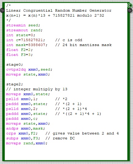

I'm trying to add a reset to MV's noise.
Original noise asm...
Being reasonably short ASM. Looking at it I thought it would be a simple way to just squeeze in a few lines in there. Similar to sync's for oscillators.
But clearly I don't understand the fundamental workings of ASM
Maybe someone can help me, or point me in the right direction. "At best" I just ended up getting any value I replace xmm0 with as constant output
Btw wen't through KG's info documents. It goes from 0 to 100 pretty quickly
// Any potential floats and stage0 additions excluded
movaps xmm1,sync //sync = polystream input;
cmpps xmm1,F0,6;
andps xmm0,initstate; //initstate = copy of state at stage0. In other words "cvtps2dq xmm0,seed;"
movaps state,xmm0;

It's not so easy to do. Specially with the limited set of asm instruction of 3.6 version.
The problem is that you need to modify an int.. Then you could no more use addps, subps that are for float.
But in 3.6 when using paddd (the int add) we need to use a variable and not a register.
Not paddd xmm0,xmm1; but paddd xmm0,x; and no sub.. So it's complex to reset an int with a condition..
I find some way but they might exist better with more advanced version of flowstone.
Way1: use skip in asm, but it need to be done four time, as i suppose that you want to reset each voice independently..
Way2 is more experimental but seams to works.. We could not reset the int state to a value, but we could reset it to zero. Then we add the initial state0 every frame of the random process..
(But now maybe it's not really true random unless we use even number as seed ???)
