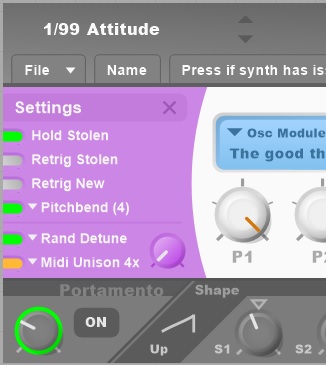

Ok I think got all the worms back in the jar and managed to closed the lid...
Here's what I ended upp with. Nothing impressive for alot of you guys, but i'm damn happy with this simple feature since I never designed my synth for it.
Poor cpu...
Multi Voice 3

First clean --> then add detune --> then add odd/even detune (multi voice) --> then add spread (using random values as modulation to my Pitch Pan section) --> etc --> finally at the end a little bit of use case of Martins recently posted "Cascade Oscillator" that now sits in my Aux Osc...
Multi Voice 4

Just me, my qwerty and audacity again...
Clicks, clicks.. clicks
Seems hard to reduce when modulating some destinations... LP... or HP filter to subtract mod wave or something... Better than slew limiter...?
Any tips?
