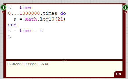

I really don't see the need for making your life harder. Just use, whatever math equation gives you the result you're after. Ever wondered, why a simple webpage graph like Desmos can show you a dozen of log curves animated at 60 fps? Correct, because it doesn't matter at all!
You gain nothing noticable from simplifying math at that level. you're not dealing with 44100 frames per second, like in blue/white, but 25 frames per second. Reducing math in blue/white will save you much more, up to significant.
And simplifying to cover an issue you have elsewhere in the schematic doesn't help either.
First find the real issue and solve it. Then look for ways to speed up the schematic. Not the other way around.
For reference: running log10 a million times (1,000,000 times) takes 7 hundreds of a second (0.07s), running it 25 times over a second is unmeasurable.
Probably (depends on the compiler and compiler options FS uses) you'll get totally different measures if the input gets changed for each function call.

juha_tp wrote:tulamide wrote:...
Probably (depends on the compiler and compiler options FS uses) you'll get totally different measures if the input gets changed for each function call.std::log10() takes about 25 to 29 rdtsc/val (variable) depending on compiler switches used (GCC 11.2, -O3 (w -ffast-math slower)) and when constant input it takes about 0.25 rdtsc/val.
Why are you bringing up a C++ compiler and argue about a few rdtsc (which btw isn't even guaranteeing to start at the same point in time on all cores)?
This isn't C++, this is interpreted Ruby running sync'd to Flowstone! And nobody really cares, if the actual number would be 1,000,000 per 0.07s or 500,000 - this is about green graphics at 25 fps.
Even if it were 10 log10 per 0.07s, it still wouldn't matter. That I have to explain this, alarms me.
