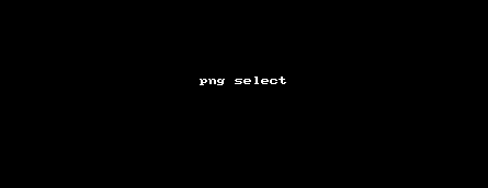

I had something like this in mind , a dropdown with PNg images , just looks so much better.
Let me see if I can hack something together from that example, although my skills are super limited
EDIT: I quickly realize that this is outside my knowledge by far. hehe
I can use the index to switch Png´s and then I make the dropdown in a custom color and font , then this might work.
If I can make the initial selector invisible and just sit on top of the PNG
Sweet

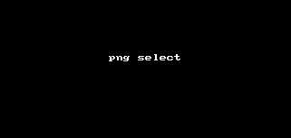

I am now trying to get rid of the top bar above the list of names so I can place this beneath the PNG and the dropdown list will appear below. is there a line that i can remove to get rid of that ?
Found it, done !

This is a slight issue , is it possible to modify this so you can close the menu again by hitting the main knob if you dont select anything ? Also , not as important , close it also if the mouse leaves the area of the knob and the menu so you cannot open multiple menus at the same time?

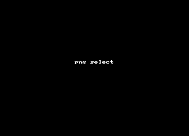

Pretty cool , just to to solve the clicking on the png to close the dropdown in case you decide not to change anything.
And the little offset of the light gray banner on top of the fonts when I go to the lowest one.
