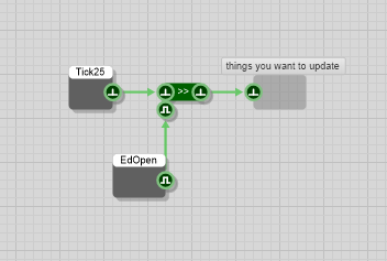

Like this. This blocks the triggers from the ticker when you do not have the vst editor open
- Capture.PNG (9.06 KiB) Viewed 14177 times
