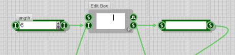

Re: INPUT Box [now to use RUBY]
Nubeat7 wrote:sorry dont get it , i`m used to type in something in and press enter to apply, like i understood the problem i would solve it like this, same as RJ already did, just with a selector in the the feed
The basic problem is, that in some situations, when you go to editbox (click to edit), value becomes invisible (this should not happen) while it's still there and is editable. But no matter into what you change it - it is invisible until you finish editing (so you don't know what you type in). The only visible thing is the cursor, which blinks after blank digit positions.
Your example is not solving it (but brings some other issues? I give up...).
- issue.png (8.96 KiB) Viewed 19212 times
hmm ok i understand more now, i designed a liitle editbox (very basic) with save/load and edit options which should work ok for editing... the more complex thing are the restrictions - length is already solved ( watch properties ) all other stuff like alpha/numerical restrictions need to be done inside the restrictions ruby code , ruby has a wide range of string manipulation but this is very specific and need to be done individual..
editbox_nubeat.fsm- (3.97 KiB) Downloaded 976 times

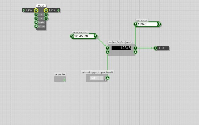

OK ... the NuBeat edit box provided some good improvements ! Thanks.
A couple of issues appeared, so looking inside I made a couple modifications. I also stripped down the schematic to focus solely on the edit box.
There was an 'alignment' problem, so I replaced the edit window sizing with a standard 'AREA' prim.
Using this, maybe as a start point.
What I'm trying to do now is have 2 addition programming controls. That would be separate control for:
1. Text COLOR
2. edit window COLOR. [the 'transparent' mode would probably be good to keep too, as another option.
I've not be able to get the coloring to work right ... could use more help please
1. Text COLOR
editbox_nubeat [RJH mod'd]-1b.fsm- (3.51 KiB) Downloaded 1096 times
work continues ... but my 'solution' is not pretty
OK .. TEXT can be edited and it stays visible. The mouse cursor can also be placed within the text to make minor corrections. Seems to work alright.
There is still an overall display problem to solve. For example, if the width of the the display is dragged to accomodate the defined text LENGTH, when you hit edit, the first letter is cut off. It almost like the the display shifts left
Getting the color stuff ... well, through a kludge was able to provide a background color. This 'example' shows how not to program ... but it does show it working.
Text in the display can also be 'justified aligned'.
Text LENGTH is also controlled.
For additional INPUT [from disk] ... data can be sent into the EDIT BOX, and then further edited.
To note: The disk data is not subject to the LEN mod. Normally the disk data would come from previous entry [and limits] from the edit box ... so this should not be an issue.
I still need to add programming limits, etc ... but this is a basic idea that will need some 'elegance' applied
here's the latest .FSM
editbox_nubeat [RJH mod'd]-1c.fsm- (4.16 KiB) Downloaded 981 times
