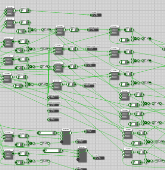

The X11Synth.
Close to a million parts inside.
This is the Scale Seq
( 6 green notes on a green counter fed by green tick supplied by ruby)[/b]
Here's a small snapshot of X11 "engine room".....

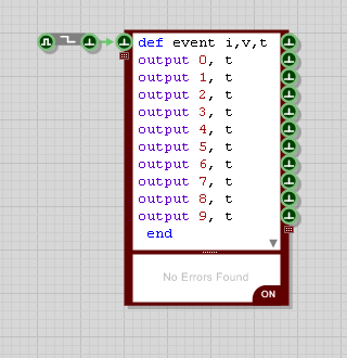

Just to prove this, I've attached a schematic that demonstrates that there can be a time difference in triggers that were generated by the same event, even when they come from the same output.

MyCo wrote:Just to prove this, I've attached a schematic that demonstrates that there can be a time difference
Thanks for that mate. Will tinker with it tomorrow when more time.
Yes, the circuit in the FSM proves it as you say.....but
Unfortunatly at the moment, the circuit dosn't apply.
Why is the ticker routed through a windows time module???
