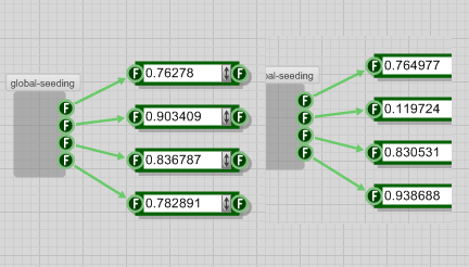

MyCo - just tested again. Always different values.
For some reason - first value is sometimes the same, but not always (I think it was more vriated in SM, or in larger design or under greater load, don't remember now). Values are different each start. Screenshot is made of 2 startups (no changes, just starting the schematic and external printscreen; to not make biliv's choices - plus video).
For green randomizer - it is a matter of seeding with time AND retriggering on start (I received this explanation from Malc some time ago).
But this similarity of seeds guides me to the question. If this FS randomnes = just irregularity (i.e. always the same pattern per seed), then maybe the random generator itself (before "latch") should be running in the background (I don't know - few per second? tkc rate?), to produce greter variation? (connected to interaction generated by user?). //edit: this one is just a thought; I don't know what difference (size) between seeds produces signifficant differences in output (as you see this is click-by-click related, not audio noise).
