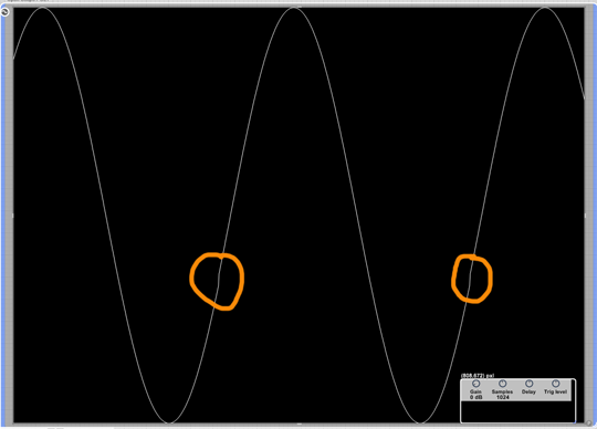

Martin, I just tried your latest (fixed) reader and the load time is now good and the CPU is even lower than your previous one.
Now here comes that big BUT…
The wrap-around glitch is back
With this version my nasty trick of resampling up to 2048 doesn’t fix it.
I should also mention that on one change of wav file the audio stream turned off. That never happened before with my current system. I suspect it’s something to do with writing stuff to memory 9 times, but I don’t know for sure.
Honestly Martin, unless you really want to carry on with this, please keep in mind that I’m happy with what I have. Of course if you would like to try other solutions I will happily test them.

Spogg wrote:The wrap-around glitch is back![]()
That's odd, it does work here. The attached demo showa a clean sinewave regardless of frequency. Distortion and aliasing would indicate a glitch but no such thing here.
Interpolated Wave Reader Test.fsm- (1.28 MiB) Downloaded 888 times
Re: Wav (Mem) to Float array issue.
Thanks Martin. I can confirm that your demo doesn’t show a glitch. I added a “Steady Scope” which works with the analyser and the sine wave was indeed pure.
I re-tried the reader from your test and used the counter from it as well (just in case) but I still got the issue.
So I’m puzzled!
So I’m puzzled!
