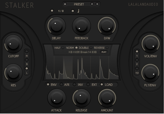

For a bit of clarity on what I am trying to achieve.
The plugin is put on a track - after a synth for example, then just loads one loop and plays it at the daw tempo whereby it controls an envelope follower that controls volume and filter, with delay capabilities on the envelope signal.Usually you dont even listen to the loop, its just a fancy modulator, and....as it stands my modulator is not sample accurate when i push play
btw, I dont have any ppq issues as I am running it with a synced ramp , only start times are off.
