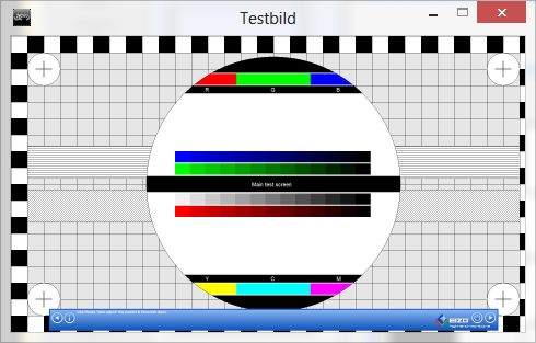

Now i checked my 1st noted bug in beta1: Compiled EXE shrinking the Gui - it's still there...

That's weird, we identified the problem and fixed it (it's working on our systems). Are you sure you've setup the path to the install folder of the beta version? When it compiles the exe with eg. 3.0.8 installfolder, then it'll use the dlls from that folder.
Nope - i always rename the path into \FlowStone_v3081 before install..
Fixed a problem with the dimensions of exported VST plugins not being correct
Maybe u didn't tested the exe version? btw: Focus mode same bug (see attachment)
