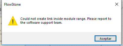

Hi all, I hope this forum (and FS at all) is no dead...
I replaced the HDD in my PC, next formatted and installed Windows 10 and all the software that was installed in the older HDD. But Flowstone 3.0.8.1 crash after launch everytime. No matter which scheme I attempt to load.
Next I installed FS 3.0.9.beta 2. It no crashes but it neither works, and it show a message (Please see the attached picture).
What can I do?
What can I do?

Re: Support
No it's not dead! It's alive and kicking!
First question...
Were you on Windows 10 before you replaced the HDD?
If no, are all your drivers, especially chipset and sound, compatible with your version of Windows 10?
First question...
