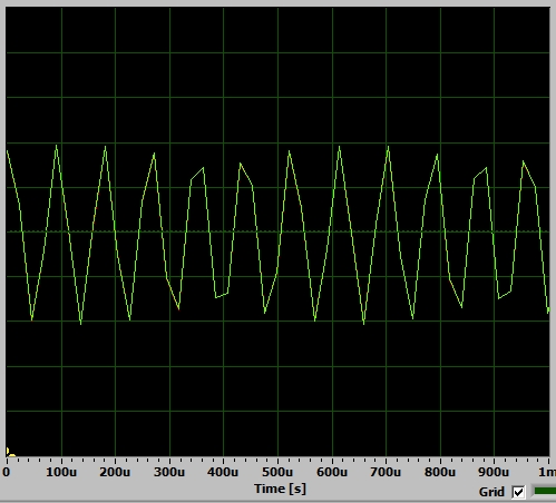

Here's a screenshot of the hookup you included, which is Martin's sine wave osc.
At 11kHz. this is what Flowstone delivers.
There are "shortcomings" to digital audio, sure, and I can't say for sure if this is a Flowstone issue, soundcard issue, etc., but this is what my 'scope shows.
I could discuss this further but I don't want to attract any 'experts' and have an instant replay of last week.
Bottom line ?
I wish I had my analog lab gear from decades ago, we could run the experiment that way.
But my 700 sq. ft. apartment says "so more room, son".
Best regards,
ROXY

Hi Chris,
Bottom line ?
Best regards,
ROXY
"Poof !"
".... vaporized........"

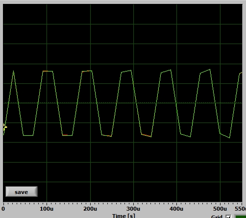

Hi Chris,
Here's a screenshot for comparison, my Wavetable generator processing a 1024 sample sine wave at 11 kHz., 12 dB down.
Quite a difference.
This waveform shows odd and even harmonics, <80 dB down.
Flowstone ?
Soundacard ?
Not perfect, but at 11kHz, not too usable musically, so it's of no concern to me.
(The triangle wave at the beginning of the trace is caused by the one shot 'grab' made by the 'scope.)
ROXY

Hi Chris,
Quite a difference.
Flowstone ?
Soundacard ?
ROXY
