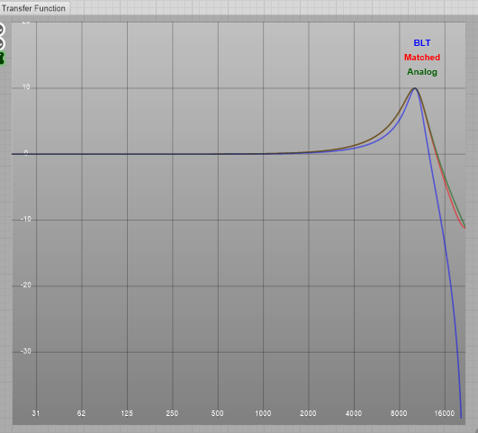

1. Would it be possible to extend your filters schematics above with a N order input? 3.order Butterworth and 4.order LR are VERY common and should be directly available in the GUI.
2. Can "the second order filters use the SVF topology with trapezoidal integration" be tuned into the various filter types (LR, Butterworth...), just as this is done by manipulating a and b parameters for the (I assume) "transposed direct form 2" ? Because it will be of value to translate the active IIR into a passive ditto with RLC values. The user of this tool might go off the standard values, and such a result should also be possible to convert to corresponding non-standard RLC values. (However, some will not translate into passive filters, various usages can be foreseen)
3. Can you grant a short explanation (for layman reader) regarding some of your terminology, like "matched biquad", "static" vs "modulateable", etc. What does this mean? What is the difference with your filter designs, compared to the standard Flowstone modules? In a few sentences, please.
It can be done for ordinary BLT-mapped filters. For matched filters without cramping near Nyquist it would be very tricky. Yes, you can cascade matched filters to build higher order filters, but the errors will accumulate.
The whole matched filter business becomes kind of oblolete as we can create literaly any filter using the FIR approach. This includes all analog filters, both magnitude and phase.
I have posted an updated schematic on slack.
https://flowstone-support.slack.com/arc ... =CAUPKDZ16
It is compiled with FS alpha. I suggest you register and get the latest FS alpha instead of using the very buggy beta.
Actually the SVF parameters (cutoff frequency and Q) are much closer to the analog world than are the biquad parameters a_i and b_i. But SVF is only 2nd order.
Analog filters have some nice scaling properties: in a double log representation of the magnitude response, changing the cutoff frequency results in a mere shifting the curve without changing its shape. Digital filters do not have this property per se because the Nyquist frequency poses a fundamental upper limit. There are various possibilities to make digital filters resemble the behavior of their analog counterparts. Perhaps the most popular is the bilinear transform (BLT), which maps the analog frequency (from 0 to infinity) on the Nyquist interval. The famous RBJ Cookbook uses BLT. The formulas for the filter coefficients are simple and explicit. The downside is that the mapping is not perfect near Nyquist, the effect is sometimes called cramping.
Matched filters intend to better reproduce the analog filter response at the expense of more complicated coefficient formulas. I have included a little demo, here is a snapshot:
Static vs. dynamic (i.e. modulateable) filters: Static filters are typically set by user interaction and then left alone. Dynamic filters may be modulated by other sources like envelope generators or LFOs. Here, coefficient updates are frequent, maybe even at audio rate.
