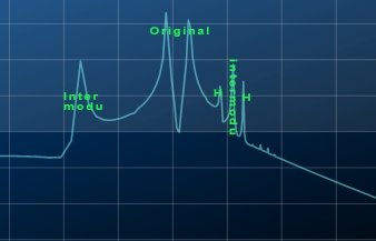

In fact my test do not harmonics but intermodulation. I forget that this is also it, because the high intermodulation sound good to my hear.
The harmonic is when an original frequency is multiplied. 800hz would make 1600hz then 2400hz then 3200hz..
But when more than one note is produced before a non-linear/overdrive process they will be intermodulation between the note.
They would produce f1+f2, the high intermodulation that i like. (But maybe it could be cool to attenuate it in some way)
But also f1-f2 and f2-f1. This give the bass intermodulation. Those one sound pretty bad to my hear.
That's why i try to use a high pass to attenuate them.
I get it from a video of Wampler pedal where he explain that most overdrive pedal use a highpass filter.
This one will be fixed in pedal. This do a great job, but i'd like to find an adaptive filter that could change when we play higher note.

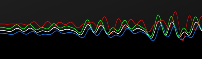

Filters add some latency, the more fast slope, higher order, the more latency you get.
In this picture i try to measure latency and group delay.
The green is the original signal. The white is the bass part of my long slope filter.
The latency is very short as the slope is long.
The blue is a more common filter with faster slope. You get more latency.
At some point if you subtract the filter from the original signal it could be better to also delay the original or you will get strange frequency curve..
The red is a filter from hell i made
there's a lot of latency but not only. Here the group delay are completely messed up. The pattern that make multiple frequency change a lot.
That's because some frequency get a very different latency than other's.
From what i read messing with the group delay could be bad especially for percussive sound.
Sometime it could be a desirable effect in some way like in spring reverb, sometime it could mess with the sound. (From what i understand.)
