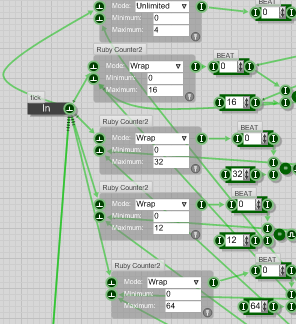

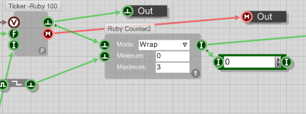

@Trog.....
Found an issue with ruby counter I can't explain :? ......
FSM= Test unit with ruby counters
In the counters module, note the 2nd counter from the top is set to 16/Wrap.
The green output from this counter never shows number 16...all good
Now in the 4 Note Seq, this counter to should be set to 4/Wrap, so i get a 0,1,2,3 output.
When I first ran it, noticed an error, missing a note, had to fix it by using a setting of 3/wrap.
This adjustment should not have been required.
Why am I getting the number 3 at the green output when it's set to wrap at 3??
2 Different behaviours from same counter...... :? :?
