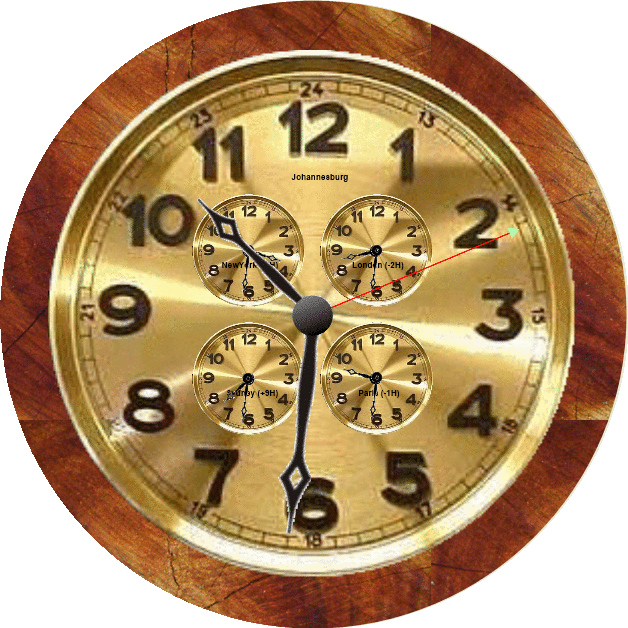

Analog World Time Clock (Picture only):
The main clock dial keep track of S.A. time Johannesburg whilst the other four smaller clocks are synchronized with it keeping time of the following: New York USA, London UK, Sydney Australia, Paris in France.
The clock has a hidden switch from where one can select 20 different shells as well as another hidden switch from where a digital clock with time, day of week, date, month, year and a snooze alarm can be selected and set.
I saw the physical clock hanging on the wall of my accountant and it was out of order long time ago. So I had a good look at it and when I got home I decided to give that old clock life again in the software world. I also gave my accountant a working copy on CD.
- Analog World Time Clock1.png (234.72 KiB) Viewed 30415 times
