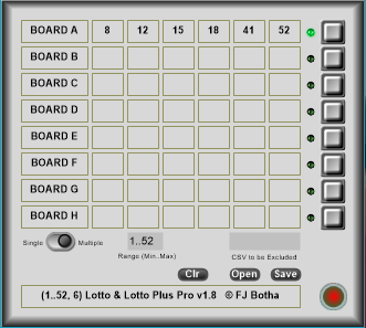

LOTTERY RANDOM NUMBER GENERATOR
A photo of a lottery random number generator which I made for fun/a challenge put to me by a person I know. Currently, it has four different choices according to which a selection can be made. The range that can be selected from can be changed and hot / cold numbers can also be omitted or added to or from the full range of numbers and be saved in a *.txt file and recalled later if needed. The switch can be set to “single” so that the range of numbers selected from is spread over all the boards A-H (i.e. each board do not have the full range of numbers available to select from, only the first board has that privilege, the second board has six less numbers to choose from and so forth) or the switch can be set to “multiple” so that the full range of numbers which can be selected from is distributed per individual board, ie each board then has the opportunity to select from the full range of numbers. Sorting of numbers is set to occur permanent. You can either select a single board (A) or the full board (A-H) or as many boards as you prefer from the row of buttons on the right-hand side. If you want to make a new selection, you press the red button once or as many times as you prefer. If you prefer you can also zoom the lottery generator software to 25%, 50%, 75%, 100% (Default setting), 125%, 150%, 200% or Full Screen by right clicking with the mouse on the generator's face and do the required selection from there. Not that I'm gambling myself and I do not recommend or promote it as your chance to win a lottery is + - 1 in 14 million – which means maybe never in a lifetime. If I feel like it, since I was also challenged to it by someone in my area, I will later on also incorporate a numerology (though myself do not believe in that kind of stuff) selector.

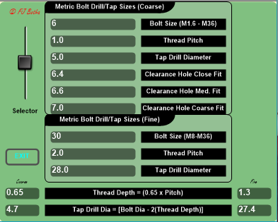

METRIC COARSE & METRIC FINE DRIL/TAP CALCULATOR (Picture only):
By moving the Slider one can select a metric Coarse bolt size from M1.6 mm up to M36 mm and at the same time a metric Fine bolt size from M8 mm up to M36 mm and read off the corresponding Drill diameter for a specific bolt size as well as thread pitch, thread depth, clearance hole size for close fit, clearance hole size for a medium fit and a clearance hole size for a coarse fit. The calculator also calculates the exact thread depth & exact tap-drill sizes for both metric coarse and metric fine bolt threads at the bottom and the nearest standard drill sizes are then displayed on the left hand side of the calculator for metric coarse and metric fine threads. This comes in handy when working on engineering tasks.
