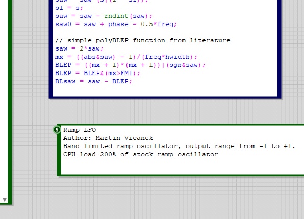

Postby R&R » Sat Dec 31, 2022 10:26 am
Just testing some more of the Osc's that Martin here made. Which was used with the LFO that Spogg shared...
200%
Why did this even make me laugh... :D
FS should come with a warning label: "Use may cause spontaneous irrational outbursts"

Postby martinvicanek » Sat Dec 31, 2022 1:27 pm
R&R wrote:200%
:lol:
Not sure if this is true, but it is definitely bad advertising of my stuff. I will have a word with the head of marketing.
:lol:

Postby R&R » Sun Jan 01, 2023 7:32 pm
...definitely bad advertising of my stuff. I will have a word with the head of marketing.
Never ever trust the marketing guys! :D
Must surely have been a typo considering your Sync Master (DSP) with the synceable polyBLEP Saws works 200% fine with my LFO. Didn't encounter any issues when testing a little...
So... 200% (up towards infinty) less drift in the PW square now 8-)
That's atleast 400% improvement i total. Tell that to marketing ;)
Only weird thing was having to set the master phase to -0.5 and the saws to 0.5 to get an initial full cycle. Might just be the staging of the DSP...I probably just need to add an inital value somewhere. Works now anyways so doesn't matter 8-)

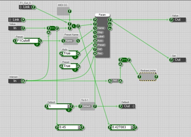

Postby R&R » Fri Jan 06, 2023 9:10 pm
Just playing around... tried to separate draw method and the interaction of the toolbox knob (ruby).
Thought I was crazy (well, "even crazier"... :lol: ). Did the trigger lose momentum? :lol: :lol: :lol:
Should this even be happening with a simple last switch prim?
(there has not been any input from the wireless and Midi cc. They are not connected)
I do understand the root cause, sort of. I'm feeding back the set value to two separate ruby code, one feeding the other. I'm not being very nice to FS with my schematic :D Kind of the point.
I don't know but I would suspect green has it's own thread(s) and ruby, perhaps has a main ruby thread?
Just a little bit weird seeing different value on each side of a last switch. I guess the value has changed but the update event (trigger) was never run, or passed along with the value (in "flow" terms :) ).
I've seen selectors that sometimes needs a little bit of encouragement with an extra trigger :lol:
