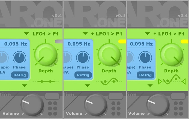

Splendid... That vector slider did the job...
Wasn't planning on having these two parameters at all from the start
But felt I had to squeeze them in on each routing due to some changes.
This is as much slider as my stomach can handle I think

v0.4 done
Didn't think I was going to be fighting "schematic size" as well.
Of course when there's 1000+ knobs and 2400+ preset prims, and surrounding logic. Size suddenly becomes a factor.
