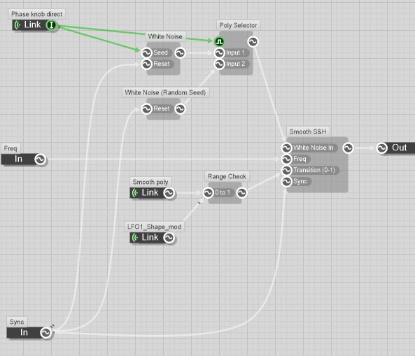

Tepeix wrote:But if each channel at the same time, why to reset the random ?
Hardsync via triggerbutton(bool)/automation for use with my LFO
The white noise is actually the source of random number sequences in MV's S&H and glide LFO modules... and maybe other things that it might be used for.
I also have an idea for a modulation-mix between his glide modules and pure waveforms. Don't know yet, if that particular idea will work...

I've had to do alot of compromises in my synth...
I just finished with throwing in MVs Noise (Random) S&H now
Since stage0: doesn't care being fed value at "poly stream start" it seems... I split
the noise into two versions, unfortunately always running at the same time to avoid schematic reloads
I also wanted a mode where seed is fed by note pitch 0-144 but that is probably just as much of a problem as
feeding any other poly to stage0: operations...?
Edit: Maybe the conversion to integer can be done at each sample instead... I'll have to look at it later.
Now on to more important issues to deal with
