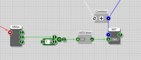

OK,
I removed some components,
and the MIDI out part->
So there are less complications now.
Yeah Bill, Entrancer hangs in alright on it's own,
but if you try and run that sampler conjunctively,
it hangs in Orion anyway.
Thanks for the heads up-that's cool though.
edit-It was crashing in EnergyXT2 too.
But I have found something.
It seems that as long as the code's names are unique,
it doesn't crash.
For example-
initaa
eventaa
in one plug &
initbb
eventbb in the other
hmm-will keep testing
it doesn't crash.
For example-
initaa
eventaa
in one plug &
initbb
