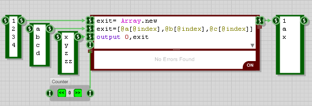

really seems like too much work using transpose...so I'm cheating with this...
Hope this helps ...
