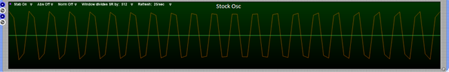

Here is a screenshot of what I get at 11K:
You can this has the slower expected sampling error, just like the wavetable-generated screenshot you posted.

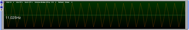

For reference, and proof that Flowstone can be just as accurate on producing high freqs as anything else, here's a screenshot of 11,025Hz (an exact multiple of the SR). Note that it shows NO difference cycle-to-cycle (pretty accurate):
