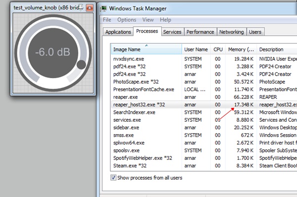

Postby lalalandsynth » Tue Jul 18, 2017 11:42 am
Volume knob test opened in Reaper 5.4 , Win 7 . Tested on 2 computers.
Took quite some wiggling and patience but it leaks.
Initial Memory before moving.
Volume knob test 1.jpg (92.17 KiB) Viewed 25853 times

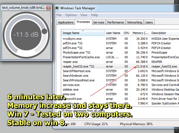

After about 6 minutes of wiggling the knob....it seems much slower then other tests but still leaks.
Therefore I will suggest you guys on Win 7 test this again , taking into account that its slower then other leaks.
After I stop moving the knob it does not let go of the memory.
Does not do this on my Win 8 machine but leaks on both Win 7 machines.
I have no clue why , I can only report what I am seeing here.
Volume knob test 2.jpg (130.01 KiB) Viewed 25853 times
