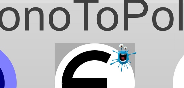

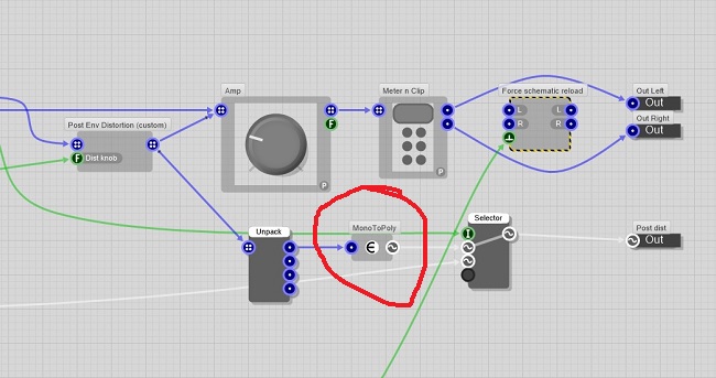

Whats causing the instability?
- This one bothered me...
- 1.jpg (69.95 KiB) Viewed 13418 times
- So I zoomed in... and... There it is!
- 2.jpg (31.91 KiB) Viewed 13418 times
- R&R
- Posts: 474
Jokes aside...
The mono2poly seems dodgy.
I think I only use like... 3 of them. Two for free running LFO and one for a scope.
Got rid of the above one for the scope. I could run the blue almost directly to the scopes graph prim instead because of an earlier change.
Think I gained back "some" stability by removing this mono2poly. But have to test more. Waiting for FS license to download 3.06 as recommended.
Me placing this particular mono2poly so late in the schematic and feeding earlier modules and prims with it might have caused unnecessary timing issues maybe.
Problem is still the free runnning LFO's.
Wish I could isolate a poly-stream and run a perpetual midi-event on that one as LFO instead. But If that was even achievable all the modulation "to and from" would have to be filtered. Doesn't seem possible in FS... but what do I know...
