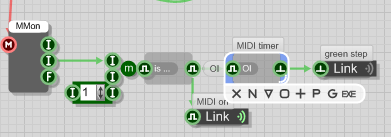

In that schematic, the example synth--
it doesn't do anything,
just makes Orion crash.
You could hook it up to a trigger counter to see if it is going.
My testbench crash is exporting the RDSP example twice with the timer above,
naming them different things.
I can't use Orion with them, and I tried briefly in eXT, and crashed it there too,
but with the arp being switched on causing it.
So now the arp is not in the testbench either.
I put it into the example, coz there may be no other flaws in that schematic,
whereas my synth has like 150,000 prims

nix wrote:In that schematic, the example synth-
Nix, The picture I took was from the Sampler ...... Not the example synth....

hmm,
maybe u r not getting the crash coz u took it out.
The timer is the module that causes the crash.
RDSP has reproduced the crash.
I'm fuffing about with 2 ticker methods now.
I'll work on DreamSequence soon.
We can communicate beteween Ruby modules with MIDI links,
like say the note goes beyond 127-
so we can have a sequencer with more than 128 steps over MIDI link.
I had unhooked the timer,
trying to locate the component causing the crash.
That timer gives a tick to the m2f in mod,
which translates the stream into green,
which triggers the random step LFO changing to a new random array, and updates accordingly in the graphic.
