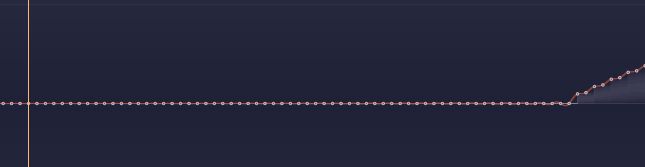

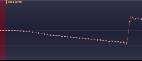

So here is the real story.
this is my timer at the very last sample before display dissappears
And here it is all the way
And here is Stock VSTi. Look how far out it is...
- Posts: 1161

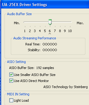

Re: Stock VSTi Fails Timing Test Using Host Seq
Just a hunch...
Is that delay pretty much the same every time?
Is your soundcard set to use a 64 sample buffer?
trogluddite wrote:s that delay pretty much the same every time
No, the drift amounts are always different.
trogluddite wrote:Is your soundcard set to use a 64 sample buffer
Tried pushing the slider to min, gets me 94.
Do I have to be at 64?
What are the ramifications here?
- Posts: 1161
Using the voices module in FL FS, instead of the midi to poly...
all good, definate movement at the very start.
So again, this is telling me the "Midi to poly" module is faulty and
Needs to be fixed to get an accurate Polarity test result....
To clarify,
Using Voices module in FLFS is picture above...
Using Midi to Poly picture below...
My cowboy fix attempts are not fixing the issue.
EDIT:
If my timer is ok ..and
The FL FS Voices is ok......this means a "true" polarity test might be viable.
But is this cheating???????????
Must both test devices be exported from FS???
So no FLFS allowed for testing.......????..... please advise.....
billv wrote:Do I have to be at 64?
No, it was just that I counted the number of samples, and there seemed to be 64 of them - powers of two always look a little suspect in cases like this.
Why did I count them? (besides geek OCD!
...When I was doing my PPQ things, you might remember that I was having trouble with FL's PPQ signal because of the latency compensation thing - the PPQ signal was exactly one buffer later than in other sequencers (or rather, the other sequencers were able to send it one buffer early)
So I was wondering whether this was a related problem - easy to fix by reading the Ruby 'frame' size. But sadly not it seems.
