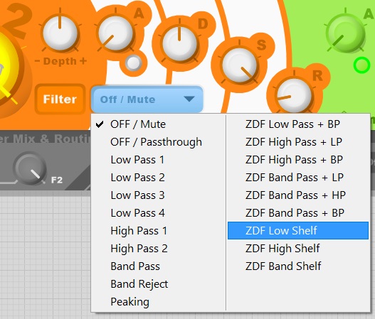

Looking at finding some additional use of MVs ZDFs in my plugin. Maybe they can act as crude EQs if my synths F2-filter is unselected/free for use... Since I won't be adding a dedicated FX or EQ section to the plugin. Too advanced for me...
Super efficient low/high shelfs by just adding outputs together?
Anyone know if I can sqeeze a little extra (due to being 2nd order) out of the ZDF's by overshooting cutoffs?
Iow is it safe to feed a cutoff slightly larger than 1 into these ZDF's? They go bananas at around 1.04< and then cuts out. Some kind of denormalization or a more regular division issue dependant of a given samplerate perhaps?
Math looks straight forward when looking at MVs original DSPs, but still I have no clue... Math
Like "gazing into the void beyond" for me
I only need to feed a cutoff of <1.03, but don't know if it might break for some reason.

Cutoff = 1 corresponds to Nyquist frequency, which is half the sampling rate. Standard bilinear mapping treats Nyquist as infinity, so you can't go beyond.
I have designed and implemented matched filters which avoid cramping at Nyquist and even allow cutoffs beyond Nyquist. Those won't modulate well, they are meant for static filtering.
Hope that helps?
Hope that helps?

martinvicanek wrote:Cutoff = 1 corresponds to Nyquist frequency, which is half the sampling rate. Standard bilinear mapping treats Nyquist as infinity, so you can't go beyond.
Hope that helps?
Thanks for explaining, helps alot...
It wasn't what I was hoping for but
I'll see if I can just add an amp reduction on the filter outputs near fully closed/open on these 2x and shelf combos in my plugin. I don't think my synth is nice to the filters, so any main filter have to handle modulation extremely well without breaking
martinvicanek wrote:I have designed and implemented matched filters which avoid cramping at Nyquist and even allow cutoffs beyond Nyquist. Those won't modulate well, they are meant for static filtering.
I do use some of your matched filters
Hmmm... maybe... I might be able to use a matched 1-pole set beyond nyquist to statically subtract a tiny bit of output. Might not cost more than a funky curve/mapping that reduces filter output amp...

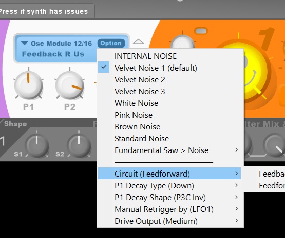

Jumping between threads...
just like I've broken my own original plan a whole lot by adding the option-dropdown to begin with.
What a letdown!
Might as well keep going.
Still not sure about naming...
The "P1 Decay..." dropdown-items? Should I call it decay, strike or exciter? It's just an oscillator for a (decay or gated) burst to get a feedback loop ringing.
Just by this screenshot what would be the most clear naming, for drawing "an only visual" conclusion of what the function is...?
What a letdown!

R&R wrote:Jumping between threads...just like I've broken my own original plan a whole lot by adding the option-dropdown to begin with.
What a letdown!![]()
