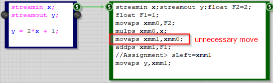

When you inspect the ASM code of a DSP codebox, you will often find unnecessary moves:
This can be a problem for long formulas like evaluationg a higher degree polynomial, where the compiler might run out of xmm registers. Note that you won't get a warning in that case!

martinvicanek wrote:This can be a problem for long formulas like evaluationg a higher degree polynomial, where the compiler might run out of xmm registers. Note that you won't get a warning in that case!
Good heads-up if I ever get to the point of prototyping more mathier stuff. That overwriting would probably taken me a while to catch...
Hmm... so basically I have entire oscillators worth of unnecessary movaps just in all of my synths multi input "range checks" spaghetti (summed together) alone
I don't know if I should consider this good news or bad news
Also noticed I've neglected to multiply by samplerate all over the place in my synth. Guess i'll just have to keep going as i'm already in the process of fixing that issue now

I spot also a strange thing in your code, don't know if it's normal, maybe some ending line are missing ?
With those 2 last :
movaps xmm7,[ebp+4224];
movaps xmm6,[ebp+4208];
you move a memory to an xmm location, but those xmm seams to do nothing with it, are they really necessary ?

Tepeix wrote:you move a memory to an xmm location, but those xmm seams to do nothing with it, are they really necessary ?
Yep looks funky...
Abrupt ending might be that I disconnected the module from its output to connect the analyzer
I've had chance to convert some more spaghetti to ASM now... with nice results. In some cases more than 1% less cpu when pushing 64 concurrent notes with a selected reference patch. Meaning, on my computer probably 4 to 8 more voices added to max playable voices, depending on set buffer size though. Still nice!
