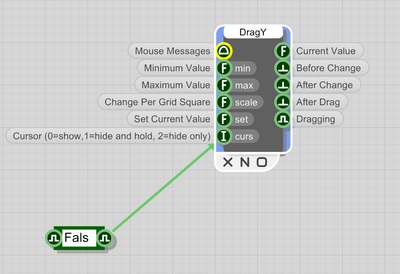

There is an issue with mouse "Drag y" primitive. When the cursor input is set to "1", it hides the cursor properly but after drag the cursor jumps to a wrong position x=0 y=0. Other modes seems to work fine (0=Show and 2=Hide only)
Drag y_ bug.fsm- (63.93 KiB) Downloaded 1909 times
