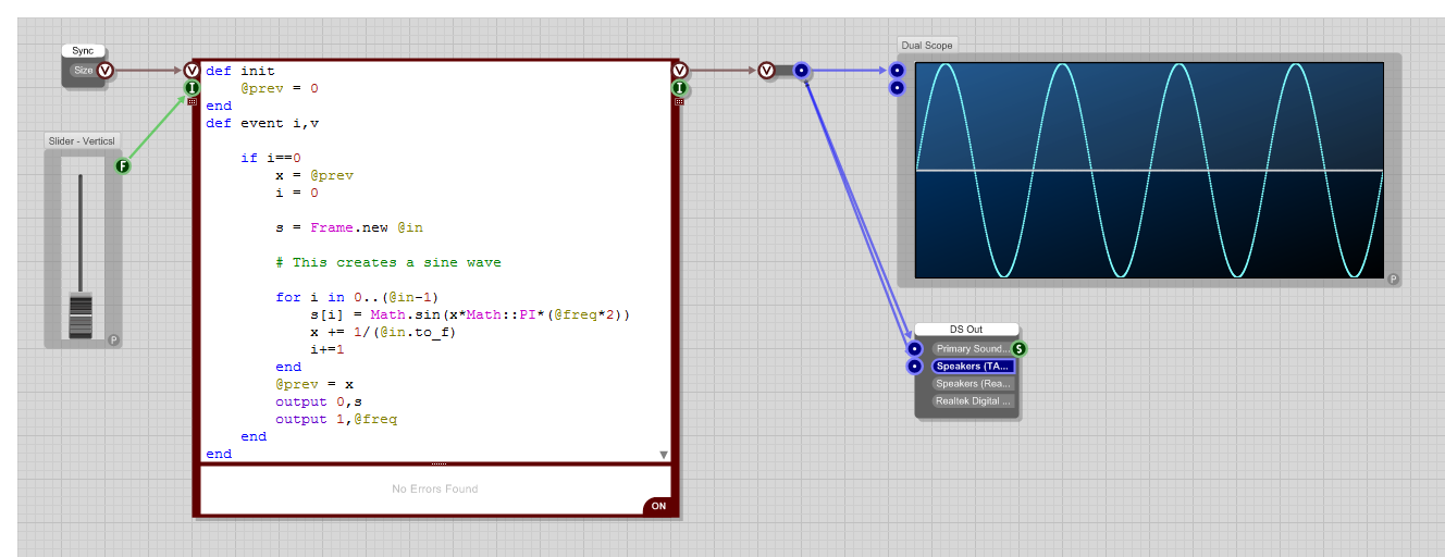

It is possible to do this in Ruby if you use the mono to frames and frames to Mono.
Here's an example of a sine wave generated in Ruby:
Ruby mono to frame sine example.fsm- (7.17 KiB) Downloaded 1255 times
